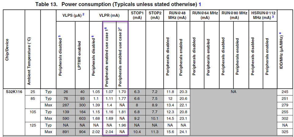

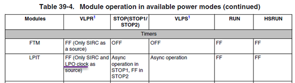

Is  THE LPIT TIMER clocked by LPO, functional in VLPR  mode ? I know it is in VLPS and we use it for periodic wake up, but how the about VLPR mode?
There is this Excel sheet called S32K1xx_ Power_Mode_Configuration (Please see the attachment)that mentions enabled case1/2 .what does that mean?

2.
Yes, LPIT clocked by LPO is fully-functional in VLPR.
3.
In the S32K1xx DS rev.12, Table 13, there are some specifications of the S32K1xx  power consumption at certain conditions which are specified excel sheet.
