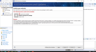

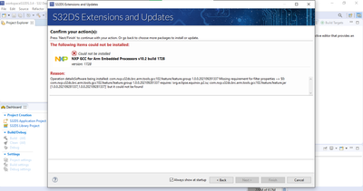

Hi Team,
I am importing example project of Multicore_singleElf So I tried to download the RTD package(SW32K3_RTD_4.4_2.0.3) and update the Extension. But, I am getting this Error. Please help me on this.
Looking forward for your response.

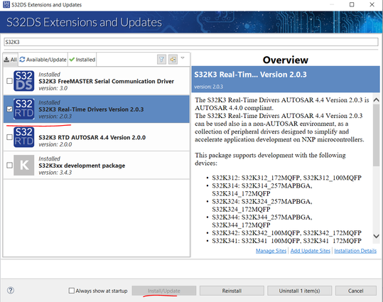

Hi@Lisha
Make sure your S32 DS V3.4 is clean.
I try to install this version from begining.
1. Offline Install V3.4 Update 3 as i said before
2.Install RTD 2.0.3
then you should able see RTD 2.0.3 in "Available/Update"
then install it(you can see i have success to installed.)

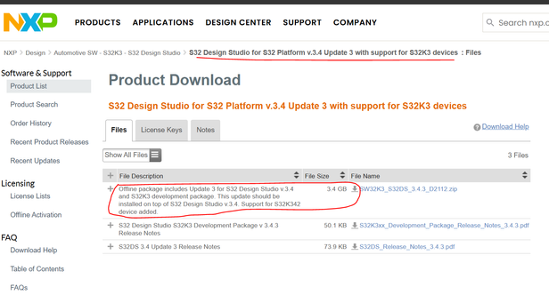

Hi@Lisa
I don't know if you followed the requirements. According to the release note, you need to install "S32 Design Studio for S32 Platform v.3.4 Update 3" first.
https://nxp.flexnetoperations.com/control/frse/download?agree=Accept&element=13216587

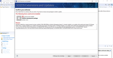

Hi Team,
Now this was showing, Could you please help us how to resolve this?
BR,
Lisha

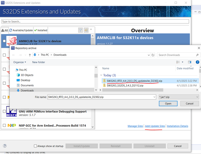

Lisha
Hi Team,

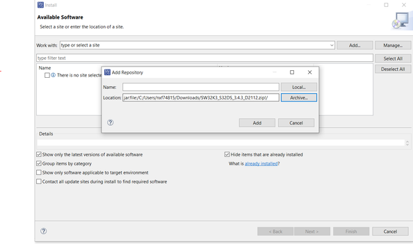

I installed all the requirements but I got the error Message only. Following method I followed,
1. Installed the S32 DS V3.4 (V3.4 update 3 window installer is not available )
2. Installing the New SW SW32K3_S32DS_3.4.3_D2112 in S32 DS.zip
3. Installing the New SW SW32K3_RTD_4.4_2.0.3_DS_updatesite_D2302.Zip
After that I update the SW Extension but It shows
Anyone Please help us, It is urgent to import the Project of Multicore Single Elf Example but This Error got me tricky.
BR,
Lisha
2,378件の閲覧回数
Senlent
Hi@Lisha
Please show me screenshots of each of your installation steps, because I have tried to install it from scratch and followed the steps in my previous reply to you, and I did not encounter such a problem.
