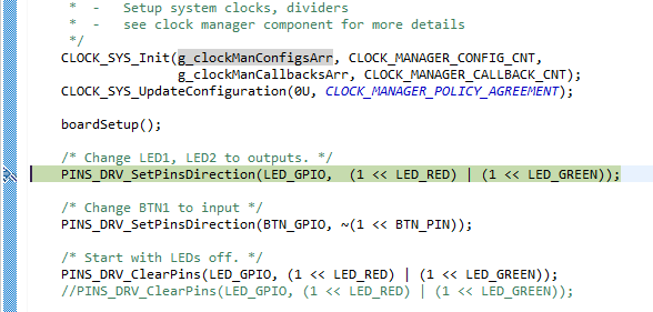

I use s32k118evb board to develop a demo application running on FLASH memory. I noticed that I cannot set a break point with my PE Micro multilink universal FX debug interface. Is this the limitation of the debug interface? How can I debug the code step by step? Do I need a new debugger?

I still have the issue with only one breakpoint. For some reason it is disabled.

No it's not for example code but my application project. Sometime breakpoints work but sometimes don't and I have no idea when will it happen.

I got the information below but I don't understand what is it for.
====== From console output ======
done
Reset script (C:\NXP\S32DS_ARM_v2.2\eclipse\plugins\com.pemicro.debug.gdbjtag.pne_5.5.7.202304031909\win32\gdi\P&E\supportFiles_ARM\NXP\S32K1xx\S32K118F256M4.mac) completed.
Error Setting Hardware BP @4f12
Error Setting Hardware BP @4f22
Warning - Not all breakpoints could be written.
Error removing BP @4f12
Error removing BP @4f22
Error Setting Hardware BP @4eb2
Error removing BP @4eb2

While debugging in Flash, you are limited by the number of hardware breakpoints. The advantage of debugging code in RAM is the availability of ‘unlimited’ software breakpoints.

When debugging code from flash memory, the debugger is limited on how many breakpoints it can set at any time by the number of hardware breakpoint units provided by the ARM CPU within the MCU.
Note: Code located in RAM can use a different mechanism offering the capability of essentially unlimited breakpoints.
Typically, the number of hardware breakpoints/watchpoints that can be set are as follows:
Cortex-M0/M0+: four breakpoints and two watchpoints

You probably activate the option "Skip All Breakpoint" at the debug view of S32DS. Could you please validate if this is your case?
