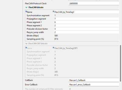

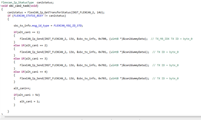

I'm facing some issue in sending CAN messages. Below is my configuration in S32K312
RTD used is 3.0.0
I'm calling sbc_can2_task() function in a 10ms task periodically. Here, only one message is getting transmitted (0x700) and other messages are not getting transmitted.
Please guide here.

what is return value of Send function for second call? Is previous transmit finished successfully?
In code it seems you are checking status for MB14, but MB13 is used for sending. Is that correct?

Dev15
I have changed to MB13 and tested. After sending 1st message successfully also it is always in busy state only.

PetrS
so is a code going into if-else statements or what is returned from GetTransferStatus. If it passes what is returned by Send function?

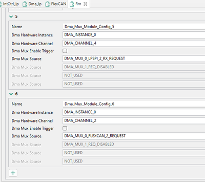

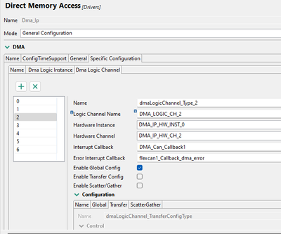

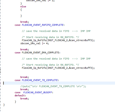

I have changed the function with FlexCAN_Ip_SendBlocking() and it is working fine, but the receive part is not working. I configured DMA for Flexcan2 and calling the function FlexCAN_Ip_RxFifo() within callback. Below is the screen shot for reference. Please guide here

I have configured Flexcan 2 using DMA and tested. CAN Rx is not working

Here, Only Tx is working fine with FlexCAN_Ip_SendBlocking() function call. Whereas, rx is not working and it displays ack and dominant error.
