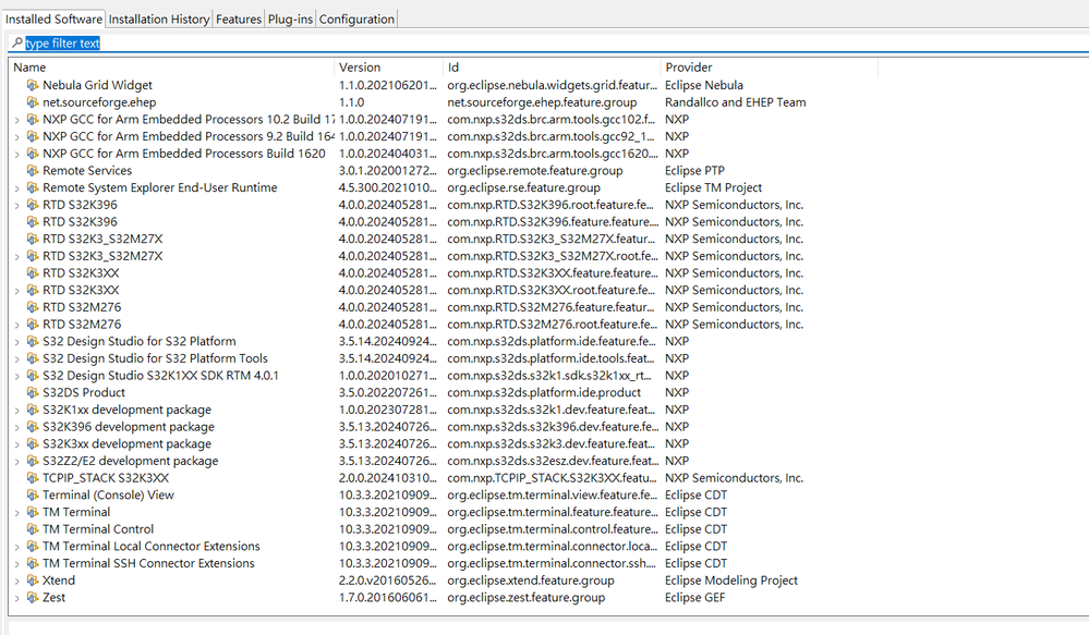

I installed S32K3 RTD 4.0.0 and update the P24.
And I installed TCPIP 2.0.0. I  can't get TCPIP example code.
My install details as blow.

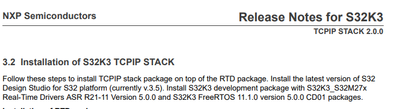

TCPIP 2.0.0 requires RTD 5.0.0 and FreeRTOS 5.0.0 installed.
For your RTD 4.0.0 you should use TCPIP 1.0.4
