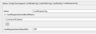

1. I want to add CAN bus off interrupt callback function in EB. I found in CANIf module, there is CanIfDispatchCfg, and if I set callback function name in CanIfDispatchUserCtrlBusOffName, and set "CDD" in CanIfDispatchUserCtrlBusOffUL, then can I set a callback function for bus off interrupt?
2. If not, can I set CAN bus interrupt callback function in EB? Here I use S32K344 and RTD 4.0.0.0.
Actually, when I follow the point 1 to set the bus off interrupt callback function, then after I build the project, some error reported, "CAN bus off callback function is not declared here".

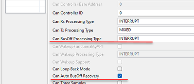

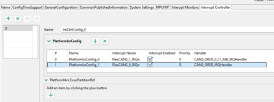

it would be enough to select interrupt processing in FlexCAN setting and add interrupt handler in Platform setting
PetrS_0-1732783259956.pngPetrS_0-1732783259956.pngPetrS_1-1732783266738.pngPetrS_1-1732783266738.png
Then CanIf_ControllerBusOff callback is called when Bus off happens.

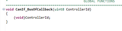

This way just applied in ASR context. Please follow steps:
1. Create 1 callback function for Bus off in main.c. User defines this function by themselves.

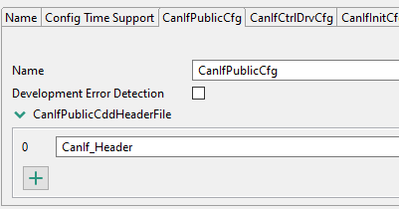

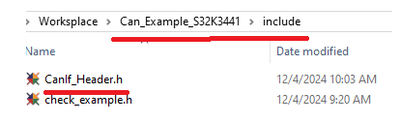

2. Create 1 header file to extern this callback function and this file will be included in Can_Cfg.c. In my case, I created CanIf_Header.h
In this file, extern the function Bus Off Callback.
3. In CanIf configuration, fill header file and Call back function name.
