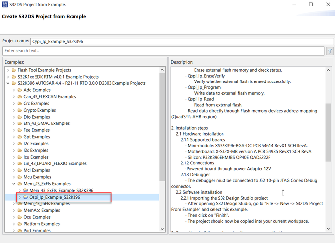

davidtosenovjan
There is a new example for the device and QuadSPI, I believe it helps you to solve your issue.
Hope it helps
