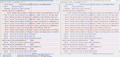

I wanna ask something about the S32K3 RTD version number.
I find that the code of module MEM_43_INFLS in version S32K3_RTD_3_0_0_P07_D2306_ASR_REL_4_7_REV_0000_20230629 and version S32K3_RTD_3_0_0_D2303_ASR_REL_4_7_REV_0000_20230331 are different in case. So I just wanna know what "P07" means in RTD version number. Thanks!

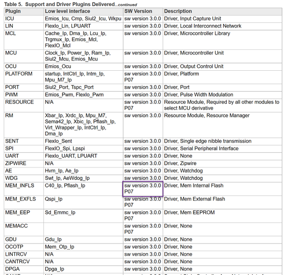

Hi @ZMY666777,
S32K3_RTD_3_0_0_P07_D2306 is Patch 07 for S32K3_RTD_3_0_0_D2303.
Refer to the release notes of S32K3_RTD_3_0_0_P07_D2306.
The driver is updated in the patch.
