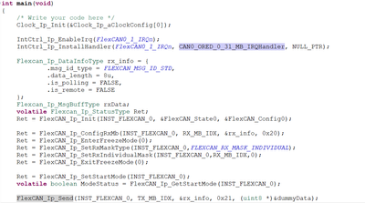

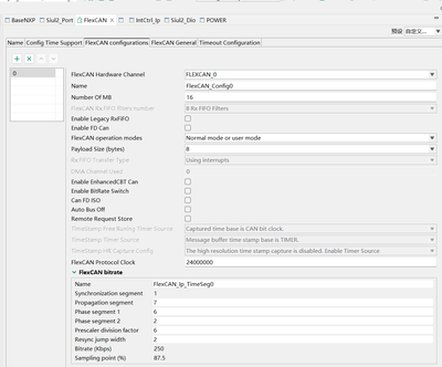

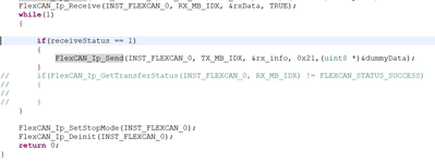

Hello everyone, I'm currently using the S32K396-BGA-DC1 development board and want to receive CAN messages via interrupts. My configuration is as shown in the attached image. However, this configuration fails to receive CAN messages successfully.
I would greatly appreciate it if anyone could point out my mistakes, provide a CAN + interrupt reception method, or a CAN + Rx FIFO reception method. Thank you in advance!

Hi @Jason88619,
From your main.c routine, I can see you are not initializing the interrupt controller driver. If you are using latest RTD, simply call the following function:
/* Initialize Interrupt */
IntCtrl_Ip_Init(&IntCtrlConfig_0);
There is no need to call IntCtrl_Ip_EnableIrq()IntCtrl_Ip_InstallHandler(), as IntCtrl_Ip_Init() does call both of these functions.
There are some examples for FlexCAN implementation in community. Please see them below:
They are not based on S32K396 derivative, but configuration and main routine should be the same.
Julián
