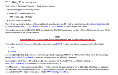

Good Morning,
I have an issue with the S32K388 on the RMII interface of a custom board.
The S32K388 is setup as the MAC and is connected to a PHY.
The issue is related with 50MHz reference clock because I want to generate it internally and send it to the PHY using the gmac1_mii_rmii_rgmii_tx_clk pin. All the examples that I have found use an external crystal oscillator (ex. S32K324 MII mode - NXP Community) but I think it is not necessarily required after reading this in the RM:
I wasn't able to find in the RM how achieve it.
Any help would be appreciated!
Thanks in advance!

Hi @javivalero ,
In theory, it is possible to generate the clock reference from the internal PLL and connect it to the gmac1_mii_rmii_rgmii_tx_clk (PTC1) pin. However this was thought for RGMII mode, not RMII.
Pavel
