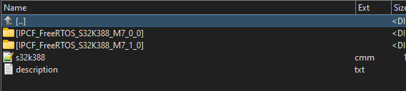

In the IPCF installation directory:
S32DS\software\PlatformSDK_S32K3\IPCF\example\IPCF_Example_S32K388\
you’ll find a .cmm script for Lauterbach.
This script automatically initializes both local and remote memory regions to zero using the following commands:
Data.Set 0x2044F000--0x2044FFFF %quad 0x0 /Verify
Data.Set 0x2049F000--0x2049FFFF %quad 0x0 /Verify
These steps are also documented in the user manual.
