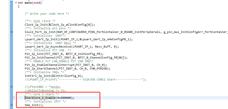

hi sir:
S32K358: How to do core 0 after the initialization clock is complete, then start core 2. I find that "MC_ME" has no kernel 2 related register.

lukaszadrapa
Hi @nxpuser007
take a look at this thread, there's an example how to start second core by software:
https://community.nxp.com/t5/S32K/S32K324-seperate-core-code/td-p/1789569
Lukas

Why does starting kernel 2 and then initializing IPCF go to hardfault?

When you step the code, where does it fail exactly?
