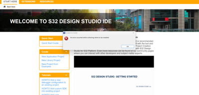

While installing the s32 packages, I am getting error, could you please give me the solution

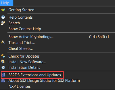

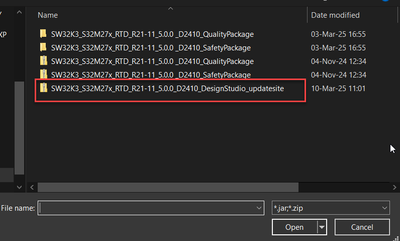

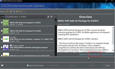

If you see this weird window during RTD installation by “Install New software..”,
maybe it can run by adding “Update Sites” in S32DS Extension and Updates” instead as happened to me
adding the zip package as downloaded before
I encountered the same problem and it worked on my side. I'm not sure the reason.
