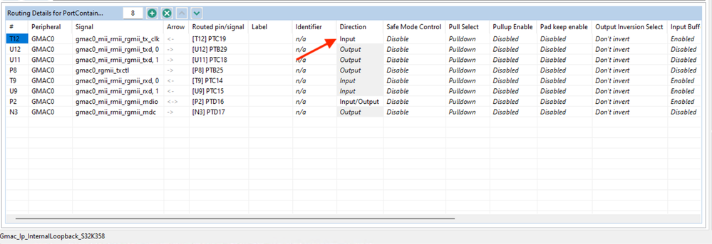

A follow up question..
In the above example, in the pins tool, gmac0_mii_rmii_rgmii_tx_clk is defined as input.
Shouldn't this be output?
thank you
-Raj

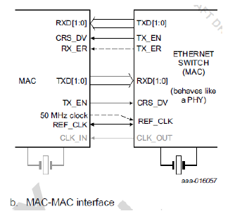

Daniel_Wax
Raj
The schematic you have provided off line does nto show the connection to the MAC of the other device.
Typically it looks like this.
Please provide your connection

rgujjari
Dan,
I shared the mcu-switch connections on our board through email.
thanks
