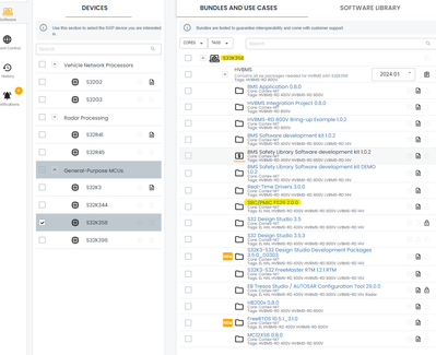

please try to use a software for the FS26 SBC from our HVBMS bundle attached. It is for the S32K358. Please let me know if it is suitable for your. If not, I will contact an application team for advice on how to fix the issue with your migrated code.

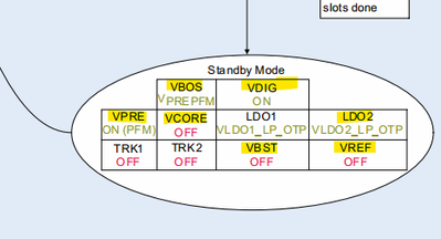

thank you for additional details. I guess the missing spi.h folder is missing in the example from the HVBMS? Let's please return to the previous issue. Please check if the FS26 has switched to STANDBY mode by checking if the relevant regulators are on and other off as suggested by an software engineer below.
DESCRIPTION
According to their software implementation, I cannot see any verification point after the call of Sbc_fs26_SetOperatingMode(SBC_FS26_OPMODE_STANDBY)
After entering Standby mode, some regulators on FS26 will be OFF, you can suggest them to check.

I have download the sample file from this link. There is plenty of other software for the S32x family. It might be interesting for you. Please note, that you need to be registered on the NXP page to be able to open it.
Meanwhile, I will contact an application team for an advice on your question.
