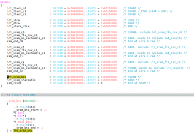

Hi Everyone,
I’m currently working on the S32K358 board and aiming to run my application on Core 2. I have successfully compiled the code for Core 2, but I ran into a limitation with the .bss section size.
I initially modified the linker script to increase the size of the .bss section, and with the below changes it worked correctly.
However, I noticed that certain memory regions remain unused. To optimize memory usage, I tried further modifying the linker script to utilize these available regions.
After below changes, the application builds successfully, but I encounter a hard fault at runtime.
Could anyone help me understand why this hard fault is occurring? Also, what is the correct and safe way to modify the linker script to effectively use the available memory for Core 2 without running into such faults?

Hi, I would recommend leaving all sections as they are, just moving their starting addresses and sizes as needed.

From my analysis:
  • The *_c2 sections are not used in the M7_0 linker script.
  • The *_c0 sections are not used in the M7_2 linker script.
  • The *_c1 sections are not used in either M7_0 or M7_2 linker scripts.
I had removed these sections myself to keep only the memory regions relevant to each core in their respective linker scripts.
I’ve also verified the generated ELF file, and the section-to-memory mappings are correct.
Could you please clarify why you recommend leaving all sections as they are?
Additionally, the memory regions int_sram_c1, int_sram_fls_rsv_c1, int_sram_no_cacheable_c1 are currently unused in the linker script. I would like to utilize this memory for Core 2.
Could you please guide me on how this memory can be properly utilized by adjusting their starting addresses and sizes?
Sathish.

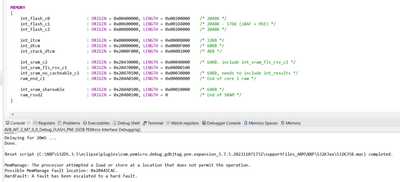

Could you attach whole your linker command file?
631 次查看
sathishkumar_sunmugavel
I have uploaded the wrong screenshot for non-working case. Please find the right one here.
