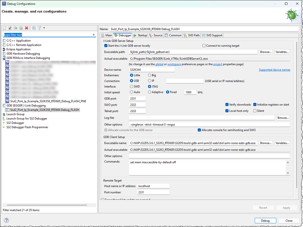

When I try to flash an example project for the S32K358 Eval Board using JTAG, the console always stops and gets stuck on "Starting target CPU...". Bellow is my full console output when running the Siul2_Dio_Ip_Example_S32K358 on S32DS for S32 Platform 3.5.

Which example did you test?
I can use Segger J-Link Plus to debug Siul2_Port_Ip_Example_S32K358 in S32DS v3.5 + S32K3 RTD 5.0.0 and S32DS v3.6 + S32K3 RTD 6.0.0.
Sorry, I am not familiar with Segger J-Link. Although I also see Starting target CPU..., the program can run normally.
It is recommended to download the latest JLink_Windows_V850_x86_64.exe and specify C:\Program Files\SEGGER\JLink_V850\JLinkGDBServerCL.exe in Executable. Can it be debugged without errors?

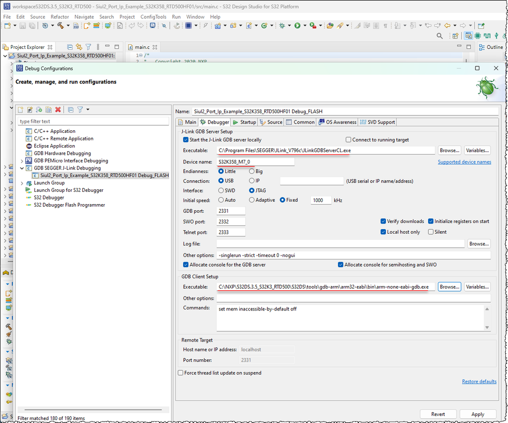

Hi Robin. I am using this setup. The problem does not seem to be the JLink setup. My jlink has been connecting. The problem I am running into is that when I attempt to run the program, it gets stuck on "Starting target CPU..." and does not seem to end/complete running. As seen in my original post, the device connects to the jlink, although once I resume or continue the debug/run, the console gets stuck on "Starting target cpu...". This does not happen when I run using the onboard debugger.

Have you updated the Segger software? I also suggest you contact Segger's technical support.

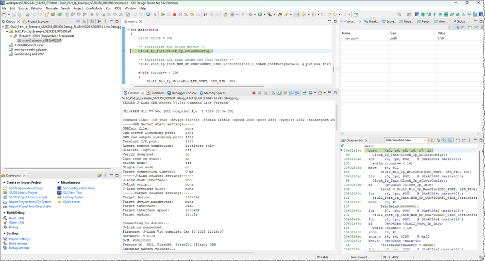

Hi - thank you for the help. I am also able to get to this exact point successfully, except I am using S32DS 3.5, the 20 Pin ARM connector, and the S32K358_M7_0 as my device name. When I try to run the program, or if debugging, resume the debugger, the program reads "Starting target CPU..." and does not seem to end/complete running.
I am unable to see any LED toggle on the eval board. I made no changes to the default example program.
963 Views
Robin_Shen
Sorry for the wrong Device Name in my last reply.(https://www.segger.com/supported-devices/nxp/s32k3)
This time I tried to use J365 (20-pin ARM standard JTAG connector), please refer to the configuration in S32DS v3.5 below:

Hi. Thank you for the reply. I am using the S32K3X8EVB-Q289. The white sticker codes are SCH-54870 REV C, 700-54870 REV A, and AX242875958. I did briefly look at the guidelines and I was able to upload and debug the example code via the onboard PE Debugger. I am now trying to figure out how to get JTAG to do the same, as long term I hope to program via JTAG on our custom S32K358 boards.

I am able to debug SCH-54870 REV B2 through J50 (20-Pin Cortex Debug + ETM Connector).
