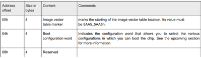

I am currently trying to understand the boot process of the S32K358 being a multicore processor.
Based on the documentation and the IPCF example, is seems like the Boot configuration word is relevant, which is stored in the IVT. I can enable cores on boot here.
This is shown as well in the IPCF example:
Snippet from startup_cm7.s:
.section ".boot_header","ax"
  .long SBAF_BOOT_MARKER /* IVT marker */
  .long (CM7_0_ENABLE << CM7_0_ENABLE_SHIFT) | (CM7_1_ENABLE << CM7_1_ENABLE_SHIFT) | (CM7_2_ENABLE << CM7_2_ENABLE_SHIFT) /* Boot configuration word */

Hi @AndreasStolze ,

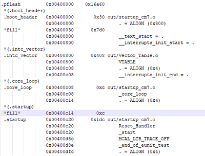

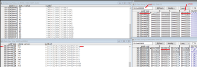

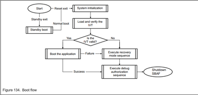

The processing of boot core as below:

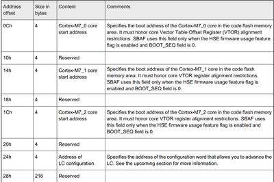

IVT structure:
Nhi_Nguyen_1-1696404765114.pngNhi_Nguyen_1-1696404765114.pngNhi_Nguyen_2-1696404782708.pngNhi_Nguyen_2-1696404782708.png
For example:
So, IVT stored in flash. You can also check this in map file:
In startup VTOR will copy to RAM, like that:
You can refer to some files startup.s, vector_table.s  in platform and run any example that was attached in the package to get detail.

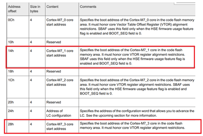

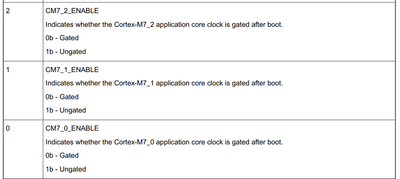

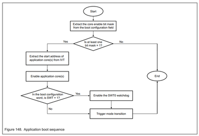

Hello @Nhi_Nguyen , related to the Andreas Stolze question: core enabling by using CM7_0_ENABLE, CM7_1_ENABLE, etc. (bits into Boot Configuration Word) are correctly read even if both HSE firmware and HSW firmware feature flag are not programmed and BOOT_SEQ = 0 (nonsecure boot usage), as default configuration.
My doubt raised because of this sentence into RM (table attached in previous answer): "SBAF uses this field only when the HSE firmware usage feature flag is enabled and BOOT_SEQ field is 0." In my case HSE firmware usage feature flag is DISABLED because I don't use HSE.
2,830件の閲覧回数
Nhi_Nguyen
Hi Differ22,
These were captured from RM:
Nhi_Nguyen_0-1703661196213.pngNhi_Nguyen_0-1703661196213.pngNhi_Nguyen_1-1703661261658.pngNhi_Nguyen_1-1703661261658.png
As you can see, there is difference between description of core CM7_3 with the remaining cores.
From this, as far as I know, we need to configure parameters to start application cores (CM7_0-CM7_3) and follow to sequence:
Core start address is where store VTOR that can't miss in the boot processing. Furthermore, as my understanding, when chip said that a field is ignored when it see specific condition, this means that if you configure this field, it not cause problem. I tried to remove this field but core can't boot correctly.
So, from my point of view, you need to configure this field.
