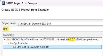

hello,
I have three questions that need help to answer, thank you!
1. can you provide a STM  sample
2. Initialize the timer module(STM), in up-counting mode, with the period set to the maximum value, and  interrupts disabled.
3. how  can  i  get  the counter  value,which interface function can be used?

Thank you for your interest in our products and for contributing to our community.
There is the Stm_Gpt_Ip_Example_S32K344 RTD example that you can take as reference:
I hope this information is helpful.
