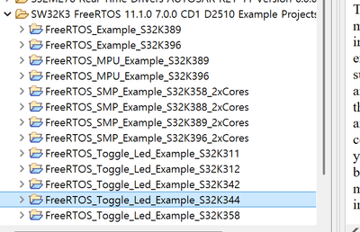

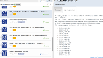

I have installed :
- S32K3_S32M27x Real-Time Drivers ASR R21-11 Version 6.0.0
- SW32K3 FreeRTOS 11.1.0 version 6.0.0 7.0.0 Code Drop
And I add an FreeRTOS Example code [FreeRTOS_Toggle_Led_Example_S32K344]

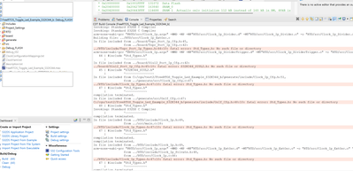

After then, I tried <Update Code and Build Project>,
The result was a ERROR.
Please Help me.

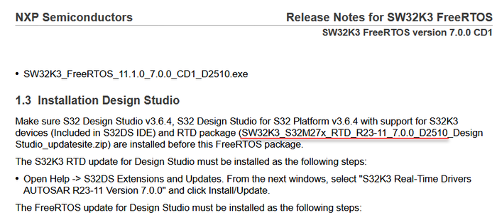

FreeRTOS version 7.0.0 is compatible with S32K3_S32M27x_RTD_R23-11_7.0.0_D2510
We cannot guarantee compatibility with S32K3_S32M27x Real-Time Drivers ASR R21-11 Version 6.0.0.
