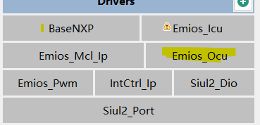

Hi,  it seems the reference project(Emios_Ocu) provided in S32 Design Studio only includes an example for emios single action output compare.
Is there a demo for S32K344 emios double action output compare(DAOC)? Thank you in advance.

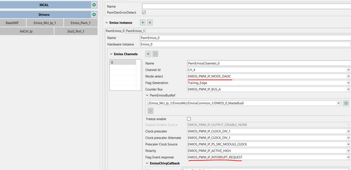

Hi@lluo
yes, you can refer to the picture i provided and it's all up to you.

Senlent
Hi@lluo
DAOC is just a one-pulse PWM and update A/B registers every period for continuous pulses.
Because DAOC can only generate a single pulse,so if you want to use DACO to generate a continuous PWM waveform, you need to call callback function periodically, so the DAOC interrupt must be turned on.

Hi @Senlent ,
Thank you for your reply. If I just want to generate a single pulse, can I use the configuration provided above? Or is the option EMIOS_PWM_IP_MODE_DAOC  only intended for generating PWM?

Hi@lluo
