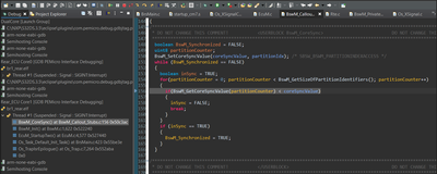

Hello, I have a project based on S32K324. Cores are decoupled. The application flashed via bootloader is not working. Core 0 waits for X-signal and core 1 gets stuck in BswM_CoreSync. What can be a problem? Thank you in advance.

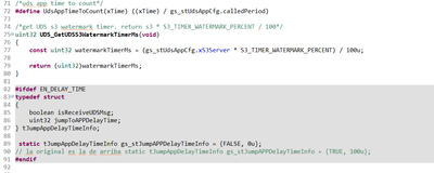

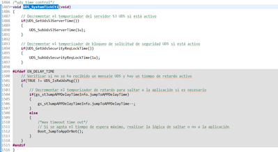

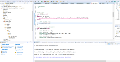

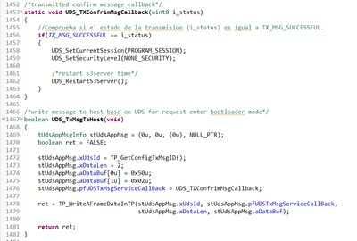

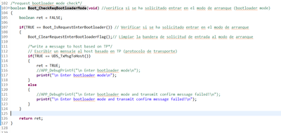

Hi, I am using the project "S32K344_Can_bootloader_RTD200" in the microprocessor S32K344. I want to download an application with the program of bootloader. I have achieved the jump from program to application but I have different questions. 1. I want to use #define EN_DELAY_TIME but when I uncomment the command in the folder "public_in", the program has different errors. My target to use "Backdoor", that is to say, I want to check if the program has to enter to bootloader or not. I don´t know the process and the different functions that I have to use to achieve the target. I want to use the function "Boot_CheckReqBootloaderMode(void)" but when I debug the program, it never enters to the "if". Could you explain me the process and the steps to achieve the target. I add different functions that I think are important. 2. I don´t know if I have to modificate the parameters of "static tJumpAppDelayTimeInfo gs_stJumpAPPDelayTimeInfo = {FALSE, 0u};". I have to change this structure ? You can see all structure in one of the next pictures. I need the reply as soon as possible since I have to send a project very soon.
Thank you for all,

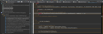

esmax
Hello. Thank you for your reply. The bootloader works properly (I think ) ). The problem exists when I link one of the tasks to core 1. In case all tasks are linked to core 0, everything works fine. Points where cores stuck are attached.
