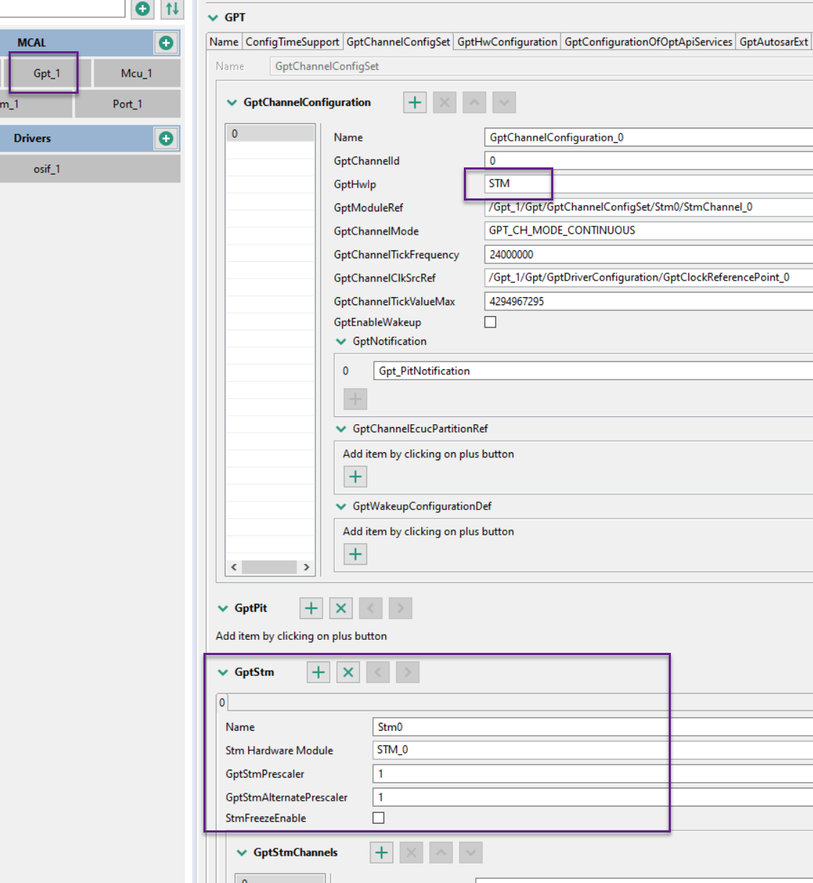

RTD drivers 2022/11 does not contain an example for STM peripheral; furthermore also the driver seems missing.
I've tried developing a driver for STM "bare metal" but I got an hard-fault exception as soon as STM_0 register are accessed (even if MC_ME clock is properly enabled for STM_0).
Can STM_0/1 peripheral be used in S32K344? Is there any example/driver?
Elker
1,611 Views
danielmartynek
Hi @elkercavina2,
There is GPT driver (also an example).
