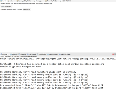

Hi, I'm having some problems
(RTD Version: SW32K3_S32M27x_RTD_R21-11_4.0.0)

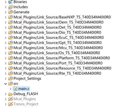

1. Intergrate MCAL Gpt Example to S32DS, and make sure no errors within Build process

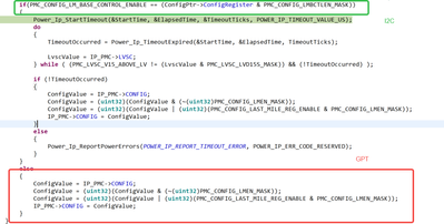

2. In function Power_Ip_PMC_PowerInit(), after running line 316, the debug process invoke error, during this IP_PMC->CONFIG'value from 0 to 1

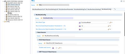

3. Detailed error and EB config
How can I fix it?

When i use another example, i found that it enter different switch
Is that means i should change the configuration of GPT examples?
703件の閲覧回数
danielmartynek
Hi @Yown,
How do you power the V15 domain of the MCU?
It can be powered directly from an SBC/PMIC or generated by the external ballast VC_BJT.
You need to configure the driver accordingly.
