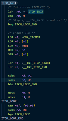

Could you please verify whether the ITCM is properly initialized in the startup code (startup_cm7.s, in the ITCM_Init section)?
I'm using the default S32DS CMSIS Core Device Startup File startup_ARMCM7.c, I'm attaching the standard .c file to this reply.
I checked the "Example_Siul2_Port_Ip_Example_S32K344_ITCM_DTCM_S32DS3.4 RTD300.zip" to get an idea of what it looks like (as shown in screenshot below for for future reference).
Does it mean that ITCM and DTCM are not initialized by default with non-RTD startup files?
I made sure that SCB->ITCMCR shows that ITCM is indeed enabled and I tried to disable->reenable on startup.

ECC initialization is device-specific and therefore not included in default startup codes. It is the responsibility of the developer to implement ECC setup according to the requirements of the target hardware. Importantly, ECC must be properly initialized before any read operations are performed on the memory.
2,666件の閲覧回数
fede_ls
Hi daniel, thank you for your support.
Following your advice, I solved my issue with implementing "Example 6. ITCM initialization by core" contained in AN13388 "S32K3 Memories Guide".
