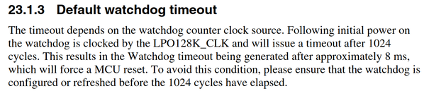

Hi @LijieDu,
The WDOG is enabled by default out of reset:

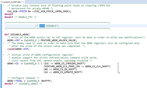

It is disabled in the Startup:

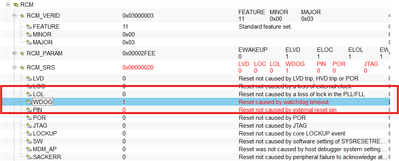

7 返答(返信)

I find the reset cause, but still confused about it, I even didn't config the wdog.

I do the ram test before disable the wdog, so it resets!
It didn't happen on s32k118(ram size is 23k), because the ram to be tested is less than 32k144(ram size is 64k).
I disable the wdog before ram test, and it run normally
