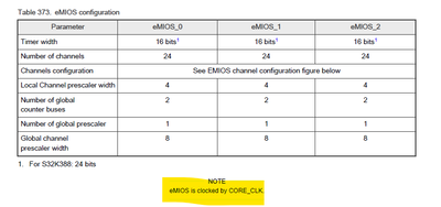

Hi @gadilinga
As shown in the S32K3xx Reference Manual, the only clock source of eMIOS is CORE_CLK and the clock limitations of S32K322 are the same as S32K344. So there should not be a problem with the clock configuration.

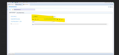

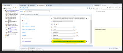

gadilinga

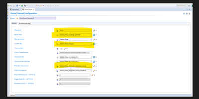

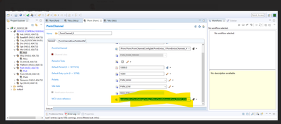

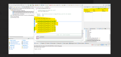

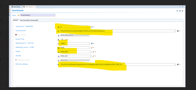

Hi @VaneB ,
thank u For Ur Quick response, Yeah As u Assumed correct only we are using S32K322 Customized Board. we Check With External Clk(FXOSC_CLK_40Mhz). And PLL also We Configured. When PLL is not Working it will take Internal FIRC CLk . so Its not getting Pin High. Whatever I shared Here I Configured Its Working In S32K344 But Its Not working In S32k322 board I didn't get Root cause of this Issue.

VaneB
Hi @gadilinga
According to the shared images the configurations seem correct, please try from the beginning setting the internal clock (FIRC) as clock source, this is to check if the problem can be caused by the external clock.

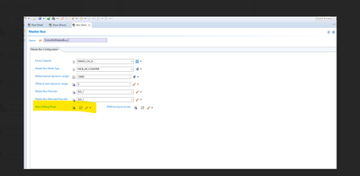

Hi @VaneB ,
Currently Issue Was Resolved, I got Root Cause was Allow Debug Mode when it Make True It was Not Working When I Make it False It was Working. So can I U Give me More Clarity On this. Thank u

Hi @VaneB,
Yeah! In S32K344 its Enable/Disable But It Working. In S32K322 if Its Enable Pwm output was Not Coming If Its Disable Its working. Another Thing Was Pin getting Low When Enable Debug Mode. So what is Relation B\W if We Allow the Debug Mode In s32K322. Could U Plz Guide US.

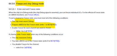

gadilinga
Hi @VaneB ,
If I enable the Allow the debug Mode it will Get set Overflow Bit.
This Is what I Seen in RM.
