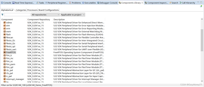

Hi,sir:
I want to build a s32k314 project with freertos, but I can not find the "components library" .
"components library" like this:
the software i had installed:
-IDE: S32DS.3.5_b220726_win32.x86_64.exe
-RTD: SW32_S32DS_OfflineDevPack_3.5.0_D2207.zip
SW32K3_RTD_4.4_2.0.1_DS_updatesite_D2207.zip
-FreeRTOS: SW32K3_FreeRTOS_10_4_6_UOS_2_0_0_DS_updatesite_D2204.zip

hi,all:
the question has been resolved, please folw the next steps.
cuiru_huaqin_0-1663292477206.pngcuiru_huaqin_1-1663292501999.pngcuiru_huaqin_2-1663292544397.png

Hi @cuiru_huaqin ,
I've followed the steps shown uplow. But it will brake down when I use  vTaskDelay.  And I use PIT_Delay_Ms, the system run well.
Could you please tell me why? The code is shown below. Thanks so much ~

Hello @cuiru_huaqin,
Please follow the release notes of the FreeRTOS extension:
BR, Daniel
3,703件の閲覧回数
cuiru_huaqin
Hi,sir:
  I have re-installed the software step by step according to the release notes(SW32K3_FreeRTOS_10_4_6_UOS_2_0_0_DS_updatesite_D2204_ReleaseNotes),but i still can not find where can add the freertos.
