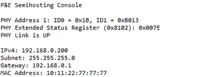

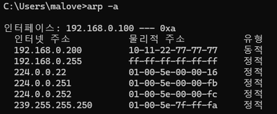

Debugging code revealed that the IP, netmask, and gateway were correctly assigned to the network interface. Additionally, the arp -a command showed that the physical connection seems to be successful.

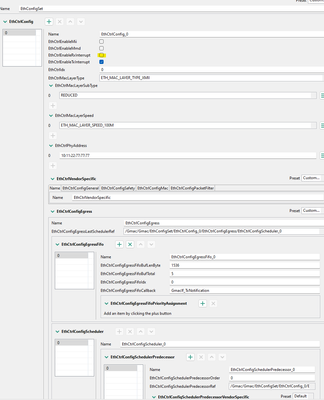

However, I discovered that the receive interrupt for the ping command is not triggered.
Could you check if there might be any issues with my interrupt settings?

PavelL
Hello @malove ,
I checked all files you have shared and I just found disabled RX interrupt in GMAC module:
I don't have hardware with S32K14 now, so I couldn't check it.
Pavel
5,311 Views
malove
Thank you for answer @PavelL
After posting this, I confirmed that the Rx interrupt was disabled.
Even after enabling the function, the interrupt still fails to occur intermittently.
What should I check in this situation?
