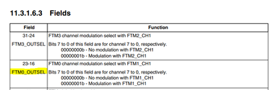

I set the FTMOPT1 register before initializing the FTM peripherals using the following lines of code:
    SIM_Type * simeBase = SIM_BASE_PTRS;
    simeBase->FTMOPT1 |= SIM_FTMOPT1_FTM0_OUTSEL(0x2A); /* 0b101010 channels 1, 3, and 5 */
Is there something I am initializing incorrectly? This behavior does not seem correct. I would expect a consistent duty cycle each period with alternating frequencies in the range of 20kHz-22kHz. To clarify, I am using an S32K142W MCU with the SDK RTM v4.0.3.

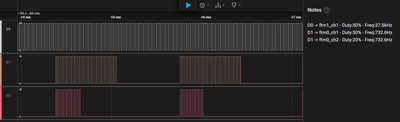

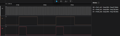

The FTM Modulation Implementation for PWM mode using FTM0_OUTSEL register looks like this.
Without modulation:
Modulation with FTM1_CH1:
At the moment I only have on hand a S32K144-Q100 to test but it should be equal for the S32K142W.
