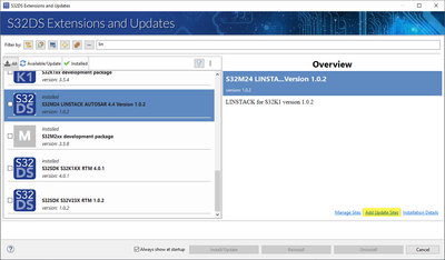

I installed S32K3_S32M27X_LINSTACK_RTM_2_0_4_D2312_Quality_Package.zip and S32K3_S32M27X_LINSTACK_RTM_2_0_4_D2312_updatesite.zip,but I have no idea that how to use these RTD files. I want to know if there is any instruction book telling me how to develop the lin function, Thanks very much.
1,737 Views
Julián_AragónM
Hi @diana_cong33,
You can follow the S32DS Installation Guide (under C:\NXP\S32DS.3.5\S32DS\help\pdf), which has the chapter "Installing product updates and packages", or this community post: S32DS Extensions & Updates: Explanation and How To Use. You can add the product by clicking "Add Update Sites" and selecting the UpdateSite.zip file.
Keep in mind that this package requires:
S32K3 platforms:
  • S32 Design Studio for S32 Platform 3.5
  • S32K3_S32M27x Real-Time Drivers ASR R21-11 Version 4.0.0
As for the LIN functions, once you install the package, you can find the LIN User Manual under C:\NXP\S32DS.3.5\S32DS\software\PlatformSDK_S32K1_S32M24\stacks\lin\documentation.
