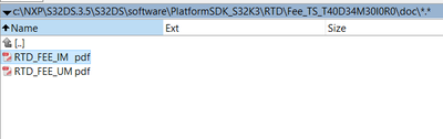

Hello
I use the S32DS tool to generate FEE and FLS components for storing data in Flash. However, there are too many configurable options for the components and the generated sample programs are too simple. So is there any detailed documentation about FEE available for users?
BestRegards
Simon
1,096件の閲覧回数
davidtosenovjan

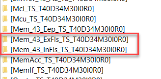

There is a user manual within installation directory as on the screenshot below:
For FLS as well
1 返信
