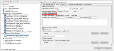

Could you share your debug configuration? It could be that the option "Connect to running target" is enabled:
Also, male sure that the option for flash breakpoints is enabled:

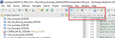

One last configuration oversight could be the "Skip all breakpoints" in S32DS:

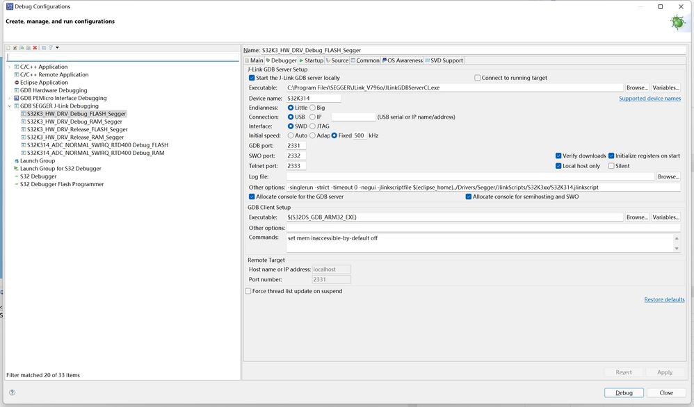

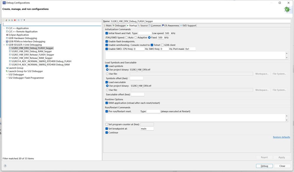

This is my debug configuration:
Also, I confirm that I have closed 'Skip all breakpoints'。
