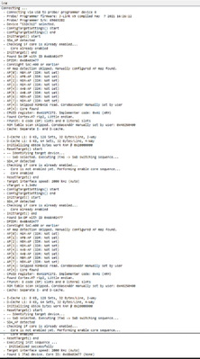

We met a very strange problem. After burning the software with pemicro's burner and powering the ECU normally, the ECU would go into infinite reset state, but we connected the ECU with a debugger (like jlink) (no extra action) and then disconnected the ECU from Jlink. Then power up the ECU, the ECU shall return to normal. May I ask what causes this?
we have HSE firmware integrated in this software. regarding to Jlink connection, we just colict the connect, and wait for successful connection information and then disconnect it. finally, the infinite reset shall be disappeared

it's not really clear what happened. If the same image is successfully loaded by different programmers, there should be no difference. Could you provide log from Pemicro? Is there anything unusual?

thanks for your reply. We done some tests we found that there is no relationship with debugger or programmer. because it shall happen for other programmer. and we add the HSE idle check the infinite reset is gone but we found that there are some other abnormal reactions(LED is not blink but CAN communication is normally ran) only the first start-up after the UTEST_1B000000 programmed,(aka first HSE installation start-up, we integrate the HSE installation with our software. ) and from the second reset, all abnormal reactions shall be disappeared, and the abnormal status was disappeared. and if we also tried removed the HSE installation step (aka don't program the UTEST_1B000000, the first start-up goes to normal.), it also works. So is there any method to fix this problem for the first start-up/reset after the UTEST_1B000000 programmed?
we use the HSE installation with IVT method to install the HSE firmware. and integrate it with our main app.

We tried to program dcf_client_utest_misc to UTEST in complaint with option F. It seems to be some difference. The infinite reset still exist. but reset happened after several seconds(App has been ran several seconds(because we can see some behavior of app working, such as LED is on). that is means that the period between the each reset is obviously longer. But just like before ,once we try to connect it with debug port, it shall go to the normal status. And we can not catch any abnormal using debugger.

One more idea - it could be caused by reset escalation. Try to set registers FRET and DRET in MC_RGM module to zero. This will disable reset escalation which could lead to infinite reset until next POR.
Then, even if more resets are triggered for some reason, the device should still run and you can check the reason. If it works a few seconds, it could be caused by watchdog. Debuggers usually disable the watchdog automatically to be able to debug the code. You can simply check FES and DES registers in MC_RGM to see the source of last reset.

We have solved this this issue. We found that if we don't check HSE_STATUS_INIT_OK in FSR, the M7 core can not be normally ran. So we add this step after HSE installation.
