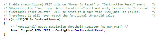

3,747件の閲覧回数
danielmartynek
Hi Simon,
In your setup, you probably see this behavior because you don't power cycle the MCU.
The driver clears the FRET register after POR or a desctructive reset only.
My test project is attached.
Once the project is loaded, power-cycle the MCU and attach the debugger back without reset.
It will be stuck in the while(stop){} loop.
The stop variable can be cleared via the debugger once attached.
You should see that the Power_Ip_Init() clears the FRET register if DES != 0.
3,696件の閲覧回数
Simon-Liu
Contributor V
Hi @danielmartynek
I learned that the registers FRET and DRET are used to set the Reset Escalation Threshold, so I set these two registers to 0 before restarting to disable the Reset Escalation Threshold. When I set the Power Reset Type to FunctionalReset, the MCU can always reset by calling the Power_Ip_PerformReset interface; if I set the Power Reset Type to DestructiveReset, the MCU will be stuck and unable to operate after calling the Power_Ip_PerformReset interface Reset 8 times.
What is the reason for this?
Looking forward for your reply, thank you.
BestRegards
Simon
3,671件の閲覧回数
danielmartynek
Hi Simon,
Your observation seems to be right.
The DRET register is cleared only after POR.
If you trigger a functional descructive reset, DES[F_POR] = 0.
But it should be cleared after any DES reset if the driver is configured with DRET = 0 (escallation disabled).
It has been reported to the RTD team,

3,729件の閲覧回数
Simon-Liu
Contributor V
Hi @danielmartynek
Thank you for your answer.
I checked your project and found that your code is the same as mine. In the Power_Ip_MC_RGM_ResetInit function in my project, there is also the processing of clears the FRET register if DES != 0. The attachment is my project. Please help to find out where the problem is.
