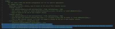

PetrS
as far as I know no demo exists for this. The driver's UM shows steps and example how to use this API in chapter 6.2.5.7 Lpspi_Ip_AsyncTransmitFast(), similar info is given in the comment above Lpspi_Ip_AsyncTransmitFast() in Lpspi_Ip.h

The first question is:

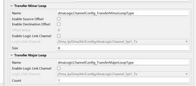

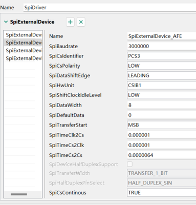

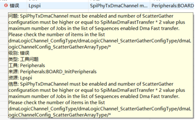

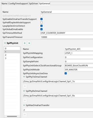

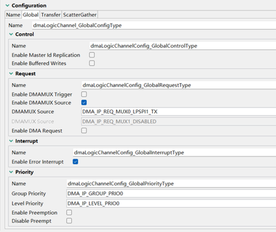

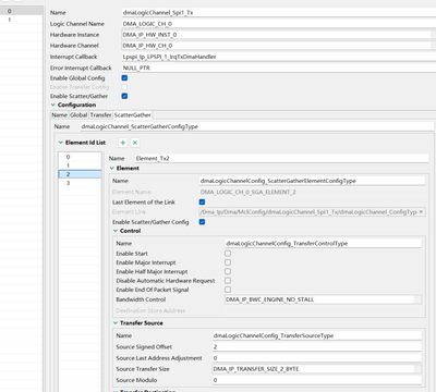

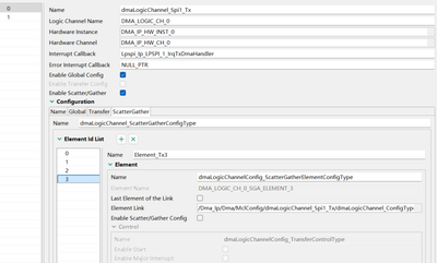

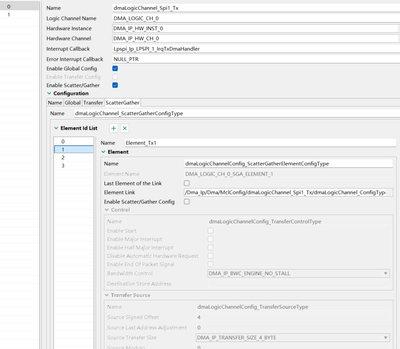

As indicated in the recommended configuration, I configured ScatterGathers configuration for three Tx channels and two Rx channels, and set SpiPhyUnit/SpiMaxDmaFastTransfer to 2. However, S32DS keeps reporting errors and prompts the following message.
I had to configure the ScatterGathers configuration for the Tx channel to four in order for S32DS to not report any errors.
The second question is:

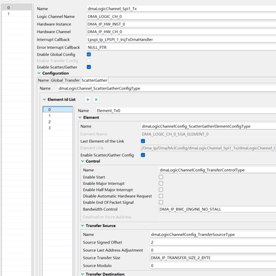

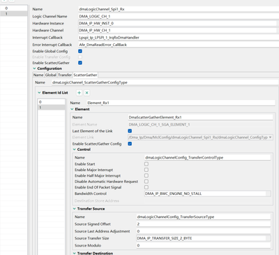

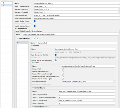

Now when I am debugging the Lpspi_ic_Asynchronous TransmitFast() interface, the Dma and Spi interrupts of Tx can be triggered normally, but the Dma and Spi interrupts of Rx cannot be triggered. After calling the Lpspi_Ip_TxDmaFinishTransfer() interface from the Tx IRQ of the SPI, the Rx interrupt cannot be triggered, and then the SPI will remain in the Busy state.
I compared the Tx and Rx channels of Spi+Dma and found that their configuration structures are roughly consistent.
Below is detailed configuration information.
txp_camel_2-1723021559518.pngtxp_camel_2-1723021559518.pngtxp_camel_3-1723021571624.pngtxp_camel_3-1723021571624.pngtxp_camel_4-1723021604841.pngtxp_camel_4-1723021604841.pngtxp_camel_5-1723021626978.pngtxp_camel_5-1723021626978.pngtxp_camel_6-1723021638394.pngtxp_camel_6-1723021638394.pngtxp_camel_7-1723021646925.pngtxp_camel_7-1723021646925.pngtxp_camel_8-1723021660682.pngtxp_camel_8-1723021660682.pngtxp_camel_9-1723021686034.pngtxp_camel_9-1723021686034.png
All transmission length configurations are set to 8
The global configuration is the same

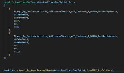

txp_camel
The following is the configuration when I call the Lpspi_ic_Asynchronous TransmitFast() interface

not sure for first one, it looks like some error message related to MCAL driver, no jobs are set in IP level setting.
For a second one, try to have Rx DMA ISR priority level higher than Tx DMA ISR.

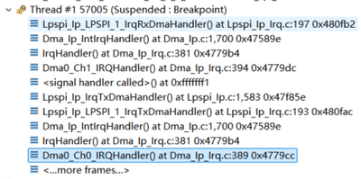

But when I don't call the Lpspi_ip_Asynchronous TransmitFast() interface and instead call the Lpspi_ip_Asynchronous Transmit() interface, the DMA Rx ISR can be triggered normally
The following is the program stack when the Lpspi_ic_Asynchronous Transmit() interface is called normally
DMA0_CH0 is the ISR of DMA Tx channel
DMA0_CH1 is the ISR of DMA Rx channel
And the ISR processing function corresponding to SPI is also called normally

Here is the answer from RTD team:
I have a S32K344 SPI fast transfer demo with RTD 4.0.0 (MCAL layer). Please check the attachment.
According to your description(in SPI IP layer driver), the actual required number of DMA scatter/gather elements should be:
  • 4 TX, 2*(TCR + TDR)
  • 2 RX, for 2 RX transfer
  • SpiMaxDmaFastTransfer=2;
Note that the above calculation method is not applicable to the MCAL layer driver.
