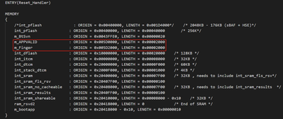

2. Configuration of linker_flash_s32k312.ld, as shown in Figure 1.
                           Figure 1
3. When using the flexio DMA example, enable the statement __attribute__ ((section(".bootApp"))) unsigned short g_u2CurrBootOrAppMode in the program. During execution, it was found that the program ran incorrectly, as shown in Figure 2. It was also noted that the bootApp address changed to 0x20408000 (with the map shown in Figure 3), instead of the 0x20417FF0 set by the linker.

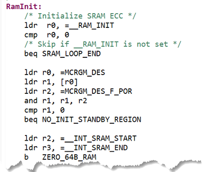

1.it will be due to SRAM ECC is not initialized for this memory area.
Try to keep ram_rsvd2 at the end of SRAM in linker file
ram_rsvd2 : ORIGIN = 0x20418000, LENGTH = 0 /* End of SRAM */

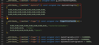

2.But when I enabled the AppCodeIntegrity and FingerPrintTestSN in the code, I found that the address of AppCodeIntegrity changed to 0x5d2016 instead of 0x5d0000, as shown in the link and code below.
3.The code is attached.

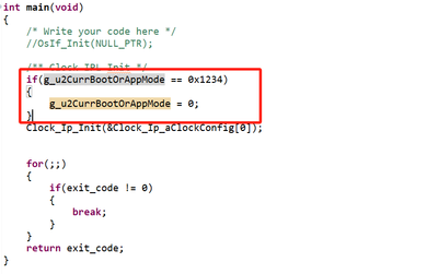

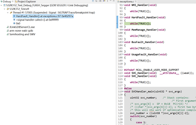

Hi NXP,
1.The previous issue has been resolved, but after adding the following statement to my main function, it still produces a HardFault.
2. The code is attached.
BR, Petr

victory
Contributor V
could you explain how the "ram_rsvd2 " works?  when after mcu reset, which stage/step ,  the hardware/ software will check this address and do the init operation, thanks
タグ(1)
2,613件の閲覧回数
PetrS
linker defines several symbols used in startup code. Here
Those are used in RamInit code section of startup_cm7.s file
BR, Petr
The problem has been solved
