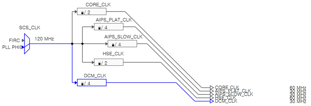

Hello.
I found clock configuration table in Reference Manual Table 145.
Is it limitation or just example?
I want to set Core Clock = 60 MHz, is it okay?

There is a NOTE in S32K3XXRM: The frequencies in the table above are maximum frequencies for a specific clock. However, any clock frequency selected must adhere to the same clock divider ratios shown in System clocking configurations.
So it is possible to set Core Clock to 60MHz, but you need to pay attention to modifying the divider of other clocks.
