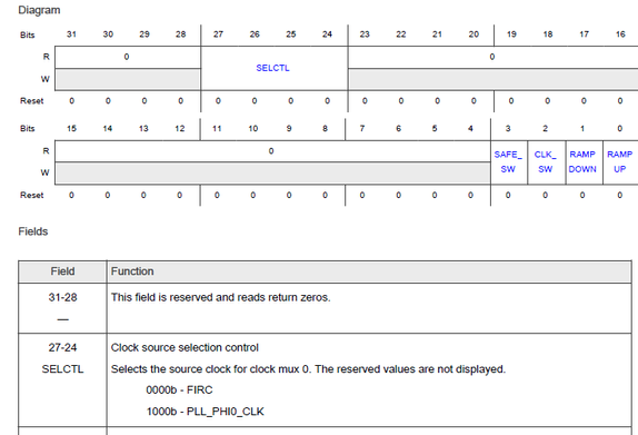

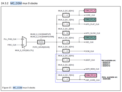

While referring to the document on generating clocks for the S32K314, I came across a question.
[Figure1]
In [Figure1], it states that MUX_0_CSC receives either PLL_PHI0_CLK or FIRC_CLK as its input.

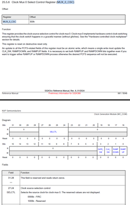

[Figure2]
However, in [Figure2], the explanation for the SELCTL bit of MSC_0_CSC only indicates that FIRC can be selected.
So, does this mean that MUX_0_CSC cannot use PLL_PHI0_CLK as a clock source?
Tags (2)
1,821 Views
Senlent
Hi@studyseok8466
Please refer to latest datasheet , "S32K3xx Reference Manual, Rev. 9, 07/2024".
1,822 Views
Senlent
Hi@studyseok8466
1,816 Views
malove
thank you!
