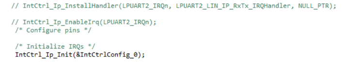

danielmartynek
Hi @johns_chuang,
I finally managed to reproduce the issue during testing.
It turns out the problem was not related to the clock configuration after all.
I was able to replicate the issue on my EVB. To do so, I had to switch the LIN hardware to UART2 (PTD6, PTD7).
Once I removed all custom interrupt handling, the communication started working correctly.
These are the changes:
You need to select the handler from Lpuart_Lin_Ip_Irq.c

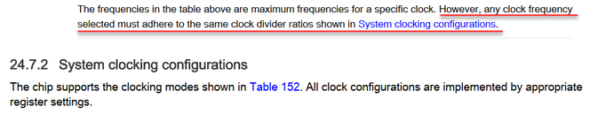

danielmartynek
Hi @johns_chuang,
The RX_HEADER_ERROR you're encountering is likely due to a timing mismatch..
Have you had a chance to measure the LIN signal using an oscilloscope?

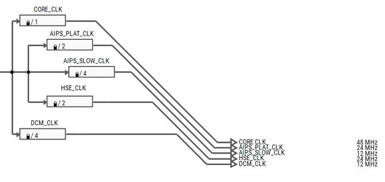

I reviewed the system clock configuration in your test project and noticed that it is not set up correctly.
If you want to have CORE_CLK = 48MHz, use Option D - Low-Speed Run mode (CORE_CLK @ 48 MHz), RM rev10, Table 162.

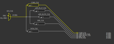

johns_chuang
Hi Daniel,
Sorry, I’m still getting used to the S32DS interface.
Could you please explain in more detail what you meant by the system clock error?
How should I correctly configure it to 48 MHz?

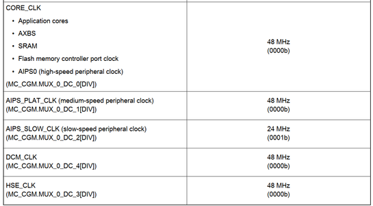

3,465件の閲覧回数
danielmartynek
Hi @johns_chuang,
Before we can proceed further, the system clock configuration must be corrected - use the S32DS GUI (configuration tool).
Please note that NXP does not guarantee the functionality of the MCU if the ratios between the system clock domains deviate from an approved configuration. Using unsupported clock settings may lead to unpredictable behavior.
If your target is to run CORE_CLK at 48 MHz, you must configure all system clocks according to Table 162, Option D – Low-Speed Run mode (as per RM Rev. 10).

3,432件の閲覧回数
johns_chuang
Hi Daniel,
Clock has been fixed, but the issue still persists. Could you kindly advise what I should check next?
Thank you again for your support.

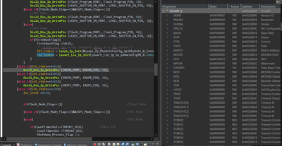

3,379件の閲覧回数
johns_chuang
Hi Daniel,
The LIN baud rate is 19200 bps.
Are you referring to the LPUART_0 registers shown in this image?

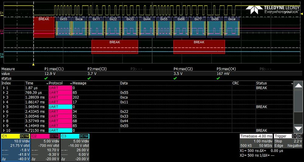

3,486件の閲覧回数
johns_chuang
Sorry, Sync was wrong. Correct LIN signal: [0x00, 0x55, 0x80, 0x11, 0x6E], ID is 0x00.
