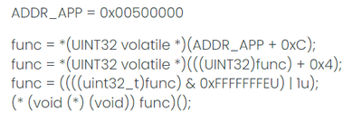

I am using the following code to jump to application.
__disable_irq();
SCB->VTOR = 0x00480000;
func = *(uint32_t volatile *)(0x00480000 + 0xC);
func = *(uint32_t volatile *)(((uint32_t)func) + 0x4);
func = ((((uint32_t)func) & 0xFFFFFFFFU)); // Reset_Handler+1 --> required to avoid hard fault
(* (void (*) (void)) func)();
But jump to application is not happening.
Can you please support me on this.
