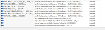

Hi NXP Team,
I am working on S32K310 controller and trying to configure the C40_Ip peripheral but it is throwing an error of Cache memory not supported. Refer to the attached screenshot. Is there any package I've missed to install? Kindly suggest.

Hi @SandyHCL
I deeply analyzed the platform support for the FLS driver features in User Mode, and the Synchronize Cache Feature is not supported by the RTD versions compliant with AUTOSAR 4.4. If you want to use this feature I would recommend using RTD versions compliant with AUTOSAR R21-11 as RTD version 3.0.0 P07.

Hi @VaneB ,
I've the Patch 07 installed already. Here are the screenshots of the packages installed in my laptop. Can you suggest what to do further?

Hi @SandyHCL
I am afraid that S32DS 3.5 has problems when has more than one RTD version installed, the suggestion is to uninstall all the RTD packages and reinstall only the ones with dependencies with the RTD 3.0.0 P07.
