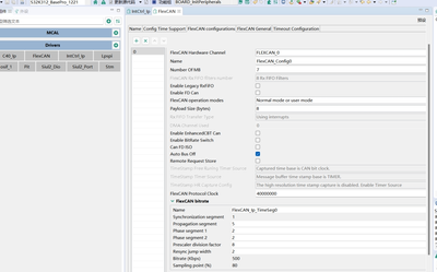

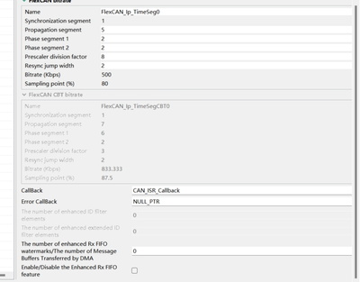

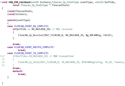

thank you ,is there any example about flexcan in S32K312, my project software about flexcan can not send data or receive data
zq1_0-1704693963301.pngzq1_0-1704693963301.pngzq1_1-1704693993682.pngzq1_1-1704693993682.pngzq1_2-1704694038679.pngzq1_2-1704694038679.pngzq1_3-1704694056227.pngzq1_3-1704694056227.png
