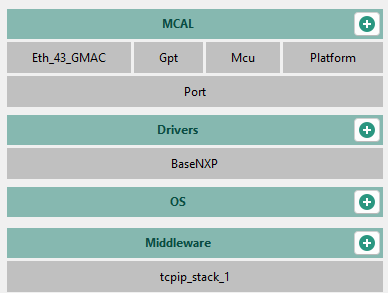

oscar_abn
I have already seen that example. The issue is that the example uses the Eth_43_Gmac component:

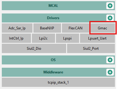

On the other hand, i would like to use the Gmac component of the Drivers section:

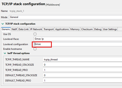

On the TCP/IP configuration i can parse the Gmac component:
However when building the project i get the following error, which suggests that Eth_43_Gmac is necessary.
../stacks/tcpip/code/ports/netif/gmacif/rtd/gmacif.c:174:10: fatal error: Eth_43_GMAC.h: No such file or directory
174 | #include "Eth_43_GMAC.h"
I would greatly appreciate any information regarding the use of the TCP/IP stack with the component mentioned.

PavelL
Hello @oscar_abn ,
you are right.
Example lwip_baremetal_s32k344 in S32DS 3.6 and TCPIP STACK 2.0.0 uses Eth_43_Gmac.
Example lwip_baremetal_s32k344 in S32DS 3.5 and TCPIP STACK 1.0.4 uses Gmac.
I'm afraid that there's no example with tcpip and Gmac in TCPIP STACK 2.0.0.
