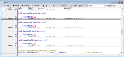

I used Lauterbach debugger for my test. First, I just used system.up command to reset the device and to enter debug mode and this is the result right after using this command:
I also tried to do power off / power on sequence and then I used system.attach command to connect to a running target. When I stop the code, it's hanging in the same loop in HardFault handler.
So, everything works as expected from my point of view.
