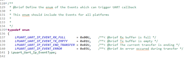

danielmartynek
Use the Lpuart_Uart_Ip_AsyncReceive() function.
And the LPUART callback.
There are these events (Lpuart_Uart_Ip_Types.h):

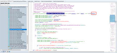

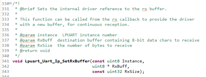

danielmartynek
There is this API that can be used to extend the AsyncReceive() call from the callback:
Also, the application can call Lpuart_Uart_Ip_GetReceiveStatus() to get the status of the call.
