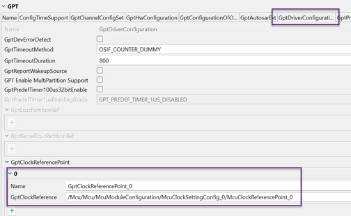

Hello.
I am testing the Iseled example code.
PIT_0 and PIT_1 are connected to AIPS_SLOW and run at a 30 MHz clock.
Why is the GptChannelTickFrequency from the GPT module outputting as 60 MHz?
BRs,
Sean Sung

Hello Sean,
You need to use McuClockReferencePoint_1
How is GptClokcReferencePoint_0 configured in GptDriverConfiguration?

ssean
Hello @danielmartynek
I made mistake that.
I was able to solve it using the method you suggested.

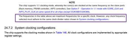

danielmartynek
Hello @ssean,
The ClockReferencePoint is configured in the MCU driver:
By the way, there is no clock option with CORE_CLK = 60MHz (RM, Section 24.7.2 System clocking configurations).
We recommend using one of the clock options.
At least the ratios between the clocks must be set to one of the clock options.

ssean
Dear @danielmartynek
There is no reference point for AIPS_SLOW_CLK in ISELED example project.
So I added like below.
The GptChannelTickFrequency of the GPT module is still outputting 60 MHz.
Shouldn't the GptChannelTickFrequency of the GPT and PIT modules be based on the AIPS_SLOW clock?
What configuration determines this output frequency?
I have already reviewed the use of the 60 MHz Core Clock.
https://community.nxp.com/t5/S32K/S32K312-Core-Clock/td-p/1978738
Is there any invalid setting value in my configuration?

danielmartynek
Hello Sean,
The ratios between the clocks seems to match this option: RM, Table 161. Option F - Operation in 1:1 mode with CORE_CLK and AIPS_PLAT_CLK at same speed.
