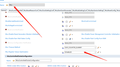

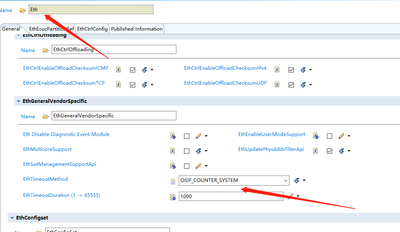

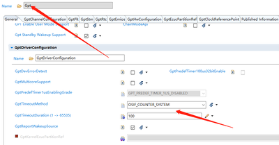

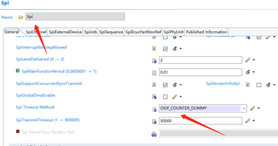

Hello.NXP team
When I use EB to configure related peripherals, I found that there is no OSIF module, but when other modules need to use the configuration in OSIF module, how can I solve it? Or, what is the relationship between OSIF module and other modules.
