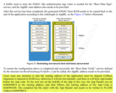

Hi @Changhawn
Do you follow this?
It's a screenshot from Secure boot application note.
You can check how it is implemented in S32K344_SecureBootBlinky project in HSE DemoExamples.
Lukas
