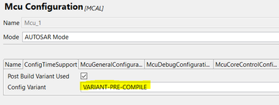

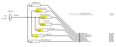

namnguyenviet
Hello @Anil_Kumar_M,
The clock was setting incorrectly in both of the two examples. Please update the clock tree for both of the example as below:
Also, in the Can_Example_S32K344, the configuration set was incorrect, it should be pre-compile:
After update above things, I can run the example successfully.
Nam
